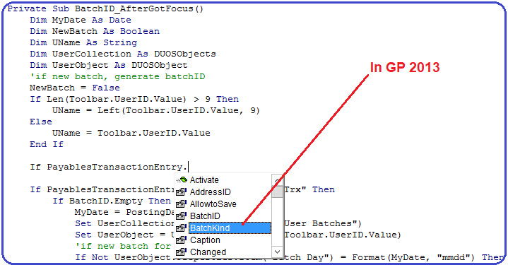

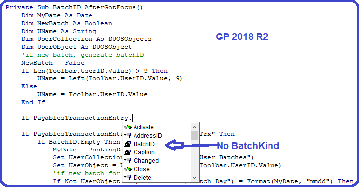

    I did run across an issue with one command option going missing in GP 2018R2
    If PayablesTransactionEntry.BatchKind = "New Trx" Then
    Is this possibly an older library issue or what?

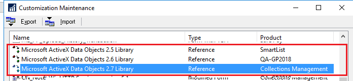

    These references exist both in the GP 2013 12.00.1538 and GP 2018 R2 18.00.0727 (R2)
    Ideas?

    Never seen a BatchKind field before. Is that an alternate window?
    Look at Display Existing Record if you want to know if this is a new batch or existing batch.

    I found the problem in a missing UpdatePrefs bit of code that was not ported to the GP 2018 instance. No more error.
    Recoding away from VBA will happen, after the update, when more time frees up.
