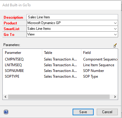

    Hello,
    I'm not sure how many are familiar with SmartList here, but I'm trying to setup a custom SmartList with a Go To that opens up the Sales Transaction's Line Item Detail for the selected record. I already have setup a Go To to open the Sales Transaction Entry window and that works fine, however the Go To for the Sales Line Item Detail just opens the Sales Transaction Entry window. Am I missing something? Below is a screenshot of how I configured the Go To

  • 3.  RE: SmartList GoTo for Sales Line Item Detail Window
    Posted 22 days ago
    Thank you for the reply and suggestion. I tested it out but all it got me was opening the Sales Transaction Entry Window, which I already have a Go To setup for that window. What I'm needing is a Go To for the Sales Item Detail Entry for a specific Line Item on a Sales Transaction in the SmartList (see below)

  • 4.  RE: SmartList GoTo for Sales Line Item Detail Window
    Posted 21 days ago
    If you only have single item on line scroll then we can add one more step to run the macro( to focus on scrolling window) and then run script Expansion Button to open detail window.
    But for multiple lines it wouldn't work. Go To functions by default are only for main windows and not for grid/scrolling windows.
    The only other option is customization to provide gp to option for detail window.
