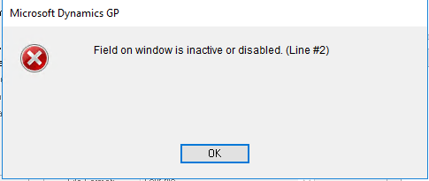

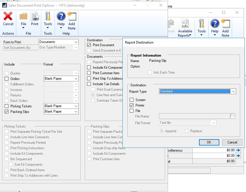

    We are experiencing an issue when trying to print Sales Orders and Packing Slips.  If we click the PRINT button or do File>Print, this window opens:  It is like a macro has been created, but we can never get to the point where we can choose to print the order.  We have searched for a .mac file but cannot find anything with that extension.
    If I go to Options > Quick Print, I get my Quick Print Setup displayed but I also get this window:
    I know this is from another macro but I cannot find the file that is being launched.
    Any other ideas where I might find the macros causing these errors?

    It does use a macro to drive the dialogs to get the print to function. The macro should be created in the workstation's %TEMP% folder.
    When you don't use the Quick Print option, it should not do anything with Macros when you print normally.  The Quick Print macro is only created and executed when you use the quick print menu option or press Ctrl-Q.

    How can I debug the "Field on window is inactive or disabled (Line2)?  This makes me think a macro was started but not completed or ended correctly.

    Are you trying to use Quick Print?  The macro file is generated, executed and deleted and that all happens very quickly.  You probably will not be able to see it happen.
    If you are trying to use Quick Print, then I would try disabling any custom code you have running in this section of GP.  For example: if your custom code has disabled a field that the Quick Print macro is trying to change (very possible), then the macro will fail.
    If you are not using Quick Print, then something else is running a macro that is trying to change a disabled field.
