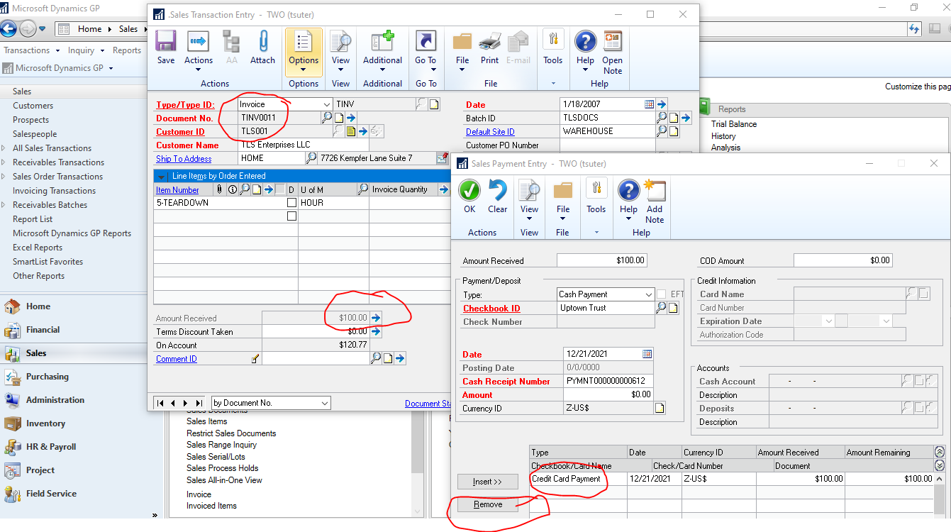

    Yes, you can remove Credit Card Payments from one SOP Invoice and reenter to another SOP Invoice as long as both are unposted.
    Go to the SOP Invoice transaction and open the Amount Received detail window. Where you see the credit card payment, chose Remove.
    You can then enter this on another unposted SOP Invoice.
