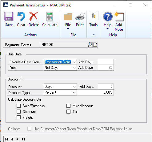

    Have you compared the Terms on the invoice to the system Payment Terms settings  (Administartion>Company>Payment Terms)?  I've seen where a person has changed the actual system Payment Terms thinking they were changing a single client's terms.  Hope that's not what is happening for you.

    @Justin Carpenter Thank you for responding.  From your answer:
    I don't have that.  This is my view GP2015R2.

  • 4.  RE: Due Date Calculations in Receivables Module
    Posted Oct 10, 2022 04:29 PM
    Thomas,
    You need to loop in someone with elevated security rights to get to that setting.    System Admin or someone with DYNSA perhaps.

  • 5.  RE: Due Date Calculations in Receivables Module
    Posted Oct 10, 2022 04:33 PM
    Edited by Thomas Hill Oct 10, 2022 05:24 PM
    I have the same rights as the GP Administrator.  I am his backup when he is out.
    EDIT:  It is Monday.
    I logged in as sa.
    This is what I see for Net 30
