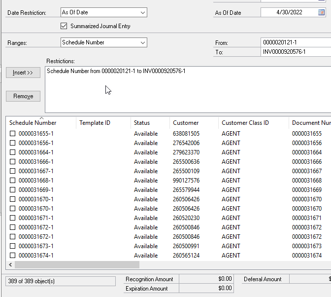

    I was able to reverse revenue in both ARED and the G/L. I now have to reverse one month the correct way but when I hit display it's pulling up over 3M objects and I normally have ~90K. Is it reversing my whole year or why so many objects? I've included a screen shot of the screen and process I tried. I thought by selecting "Reverse Journal Entry" it would only reverse the month I'm requesting. How can I reverse just June 2022. is an Event Based option?
