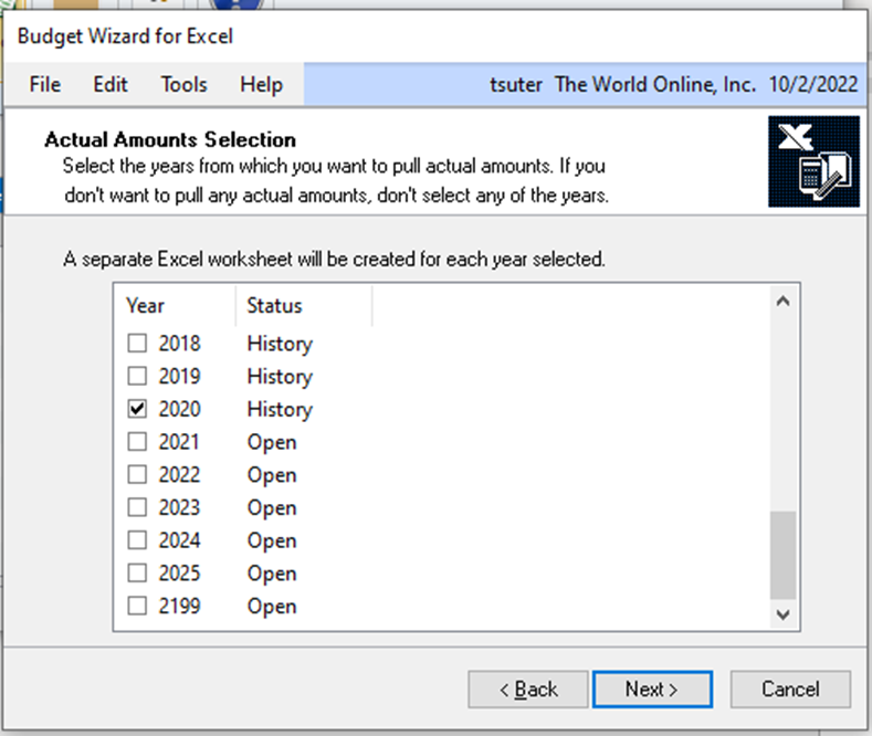

  • 4.  RE: Budget and Actual - Month to Month
    Posted Oct 03, 2022 02:19 PM
    Typically the Budget Wizard for Excel would produce an Excel file with at least two worksheets as follows:
    Worksheet 1. Budget Year 2023 by period - the values normally would be blank for the managers to fill in if you chose Blank. Or you can fill it in based on a prior year.
    Worksheet 2. Actual Year 2022 by period - but since the year is not complete, I would also add Worksheet 3 for 2021.
    Worksheet 3. Actual Year 2021 by period
    So the Managers get one excel file for their department accounts with one worksheet for the budget and other worksheets (2 and 3 etc) with Actuals as a reference to use when completing Worksheet one.
    For each year I mark in the following window they get another Worksheet of Actuals.
  • 5.  RE: Budget and Actual - Month to Month
    Posted Oct 05, 2022 03:07 PM
    Thank you Thaddeus!  I was able to follow your sample and it works.
