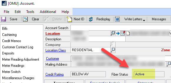

    My Customer Service department has requested that the backcolor of a field that I have added on a form change depending upon what gets populated in that field.  For example, if the field displays "Active", they would want the backcolor set to Green, etc...

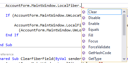

    I have some experience with adding fields and populating them with data through .NET and then adding that .dll to the addin folder but I can't figure out how to access the backcolor property on that field.
    I have imported the Microsoft.Dexterity.Bridge as well as MIcrosoft.Dexterity.Applications in my code so I am able to access some of the field properties such as Value, Focus, Clear but nothing regarding backcolor...
    Do any of you programmers have an idea as to how to access the backcolor on that field?  Do I need to reference something else that has those properties included?

    Thanks to David's help and GP Power Tools, we were able to accomplish the setting of the backcolor property depending upon what gets populated in that field.  He was also very gracious and took the time to show me other features of GP Power Tools.
