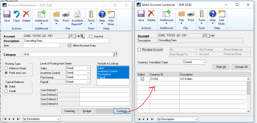

    You can import the COA to the company that does not use USD as their functional currency. If you are going to be reporting transactions in this company in USD the Select Account Currencies window has to be populated:
    My apologies for not being able to answer this as I am not well versed in IM, but if the import includes this window/field it will save having to create a Macro or manually enter this information after the import.

    Which version of GP are you using ?  PSTL is not able to re-assign a different currency on the fly while copying a company, because it will only offer you to select to copy the "Financials" setup without any other options. To copy the basic setup only, just leave the 'Data' checkbox blank.
    However, you can go after the copy into the new company and use the Currency Account Mass update function to change the currency of your accounts.. That should definitely do the trick.
    Financial >> Cards >> Financial >> Currency Account Update
    Use the Multicurrency Mass Account Update window to update a range of existing accounts with multicurrency information. You can select a range of accounts to mark for revaluation, update the translation method or assign additional currencies to the accounts.
