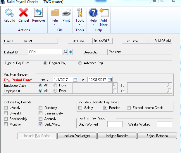

5. Create a special Payroll Check ID called PENSION or 1099R so you can "build" these payments separately from any other pay run. Mark it as Pension and Daily/Misc with the full year range. See screen shot below.
