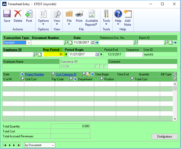

    It has been noticed by our payroll person that the Time period is not correct.  We are suppose to be on week 50 but the screen shows 51.  This is the highlighted item on the picture below.  We believe this is due to leap year but are not 100 percent sure.  We are wondering what our options would be to resolve this issue.  I know I can change the starting date in payroll setup but do not know what all that will touch.  If this is the correct solution, would it be best to change it at the beginning of our new payroll year.

    Last year (2016) was a 53 week year so your Project Accounting settings should have been 53 weeks last year not 52 weeks.  Each year you slip 1 or 2 days as 52 weeks does not = 365 days.
    You must add the 53rd week every 5-6 years.
    This year (2017) then would have been OK but.... your 2015 was wrong and maybe even earlier.
    The 52 week period should normally be ending this year on exactly Sunday 12/31/2017.
    The current period 11/27-12/3 should be period 48 not 51 for a calendar year.
    The resolution for you is to set 2017 in PA to have 55 weeks so that period 55 for 2017 ends on 12/31/2017. Then you reset it back to 52 weeks for 2018 before people start entering 2018 time.
    If you do not set it forward in 2017,  then Period 1 for 2018 for you will begin on 12/11/2017. Probably not what you want.

    I made the change and it shows up in both the setup table and window.  As you can see our first date was 12/29/2003 which would have started the issue (way before me).  I decided to look at the timesheets to make sure it will show periods 53, 54 and 55.  It does not show them.  It shows as 1, 2 and 3.  If I type 55 in the period, it appears with the correct date.  When I use the arrow to toggle to the next date, it appears as 4.  If I toggle back, it shows as week 3.  I confirmed that there are not predated timesheets.
    Am I missing something?

    No, you are not missing anything. By setting the periods to 55,  GP will now allow a period 55 but does not default it in.
    Normally you are only dealing with a period 53 and you make sure everyone knows to do their timesheet to period 53 not to 1. BBucher reminded me that in BP you cannot control the period.
    In your case you have 53, 54, and 55 periods before you want to start again with 1 and the users will never understand it. So set the value to 55 as you have.
    Then monitor your PDK10000 and PA10000 and update the Year and Period columns before you post the batches.  Now it won't matter what the users send in or what defaults in.
    1-2018 becomes 53-2017
    2-2018 becomes 54-2017
    3-2018 becomes 55-2017
    After you have all your timesheets in for 2017 change the periods back to 52.

    Mystery of the -2 extension partially explained.. for some reasons, the TS reports in some companies got assigned the Period 27 instead of 51, which caused the duplicate finding for BP / PDK.. which does not include the Document number in the validation, but only the PAYR & PAREPD combo.. if there has been already an entry with -1, the nextg becomes -2 and so on..
    So all I have to do is rename the PAREPD from 27 to 51 and watch for the next weekly TS.. which certainly are going to have wrong periods too.. but still can't exlplain why.​
