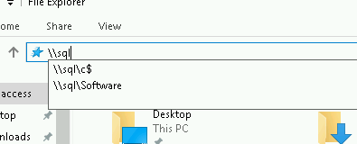

    Can that user open a Windows Explorer and access that folder ?
    "\\crown\report share\"
    As there is a space in the share name (which is never a good idea) you need to put it into quotes or use the Windows Explorer to 'navigate' there.
    Technically when you open the browser field in Windows Explorer and start typing the server name ( \\crown\ ), the shares should pop-up by themselves..
    like below :
    Once the shared folder is open, have the user try to create an empty TXT file or a new folder, just to make sure they have full rights to Write data (this is critical for GP).
