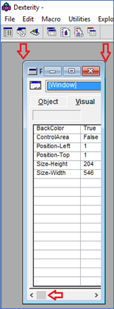

    Can anyone tell me how to correct a Dexterity annoyance? We are on GP 2018 R2.
    My Properties windows cannot be resized wider and are way too narrow. Clicking it seems to make it worse!

    Open the DEX.DIC
    Add a button on the "Properties" window of form "Window Layout" with a call to " Window_SetBaseSize() "

    Hi David
    I wrote this as a blog as I have seen it many times.
    https://winthropdc.wordpress.com/2020/06/04/dexterity-fixing-the-properties-window-width/
    PS: Hope you don't mind me using your screenshot.

    @David Musgrave
    I don't mind at all David, glad it was clear enough to be useful. ​
    I was certain someone else besides myself had gotten tired with that little annoyance, but a search didn't turn up anything. Dexterity is exotic enough without the quirk.
