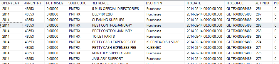

If your distributions only have the one entry like in your report Victoria's suggestion will work great.  However, if there are multiple distributions with the same Journal Entry then if you did a select in the table like this:
select * from GL20000
where JRNENTRY = 46553  -- Change this to the appropriate Journal Entry
You might see something like this(taken from my test company):
In that case select your line and scroll all the way to the right and make note of the DEX_ROW_ID, because if you update based on JRNENTRY then the DSCRIPTN for ALL the lines will be changed and not just the one line.
update GL20000
set DSCRIPTN = 'New Distribution Reference' -- change this
where DEX_ROW_ID = 123456 -- change this to the DEX ROW ID number
