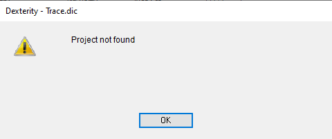

    If I go up one level in the Root Directory (leaving it as c:\~Work\DevOps\ ) and then click on the ellipses to look up the Project Name, I get the useful error:

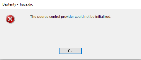

    However, if I go down another level in the Root Directory to c:\~Work\DevOps\TRACE14\ and click on the ellipses, Dexterity either shuts down without any error or I get the following error:

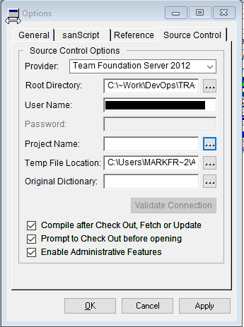

    My questions are:
    1. Am I correct in assuming that the setup of VS with our DevOps service would be the same as TFS?
    2. In VS, I have set up the local path for the DevOps project as c:\~Work\DevOps\TRACE14, which I assume is correct.
    3. With the user name in the Source Control window in Dexterity, I have tried both my fully qualified domain name and my email address.  I know with TFS, the fully qualified name is the correct one.  But with DevOps, my email address is what is registered, which is the same for Dynamics 365 and Office 365.  Is the issue with Dexterity not accepting my email a the user name?
    4. Is the "Project Not Found" error related to DevOps or my local path?

    If I click on the ellipsis, I get the sign-on to Team Foundation Server.
    I had to have Visual Studio 2012 with a very specific patch level to make this all work.

    Thanks David.  According to Mariano, I need service pack 5 for VS 2012.  I will check what service pack I have.  I think we only installed 2012 because of TFS.  We do all of our SSRS and SSIS development in 2015 or 2017.

    Just as a follow up, I have VS 2012 update 5 installed, as well as VS 2015 and VS 2017.  I have our DevOps service set up and connected in all 3 versions, but I am still not able to connect in Dexterity.  This is really starting to frustrate me now.
