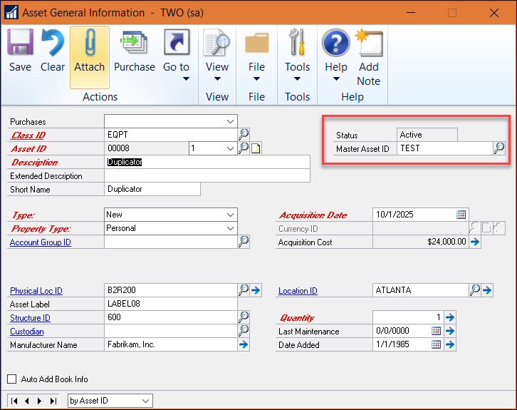

    Two, you can open the Asset General Card and assign them both to a new "Master Asset ID" which can then be reported on and grouped together.  OR you can just make one of the extant two assets the Master Asset ID (I'm not a fan of this idea).
