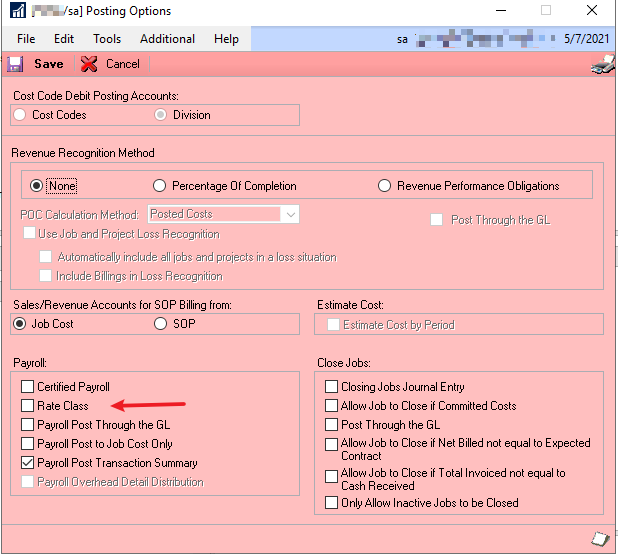

    The Rate Class option only shows up when it is enabled in the Job cost posting options :
    Please check Wennsoft's documentation on that topic:
    https://docs.key2act.io/1803b05/signature-job-cost/job-cost-setup/setting-up-payroll-for-job-cost/setting-up-rate-classes-for-union-payroll
