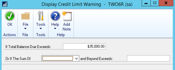

    when the credit limit is setup on the customer card, you can specify if it's only a dollar limit or if its a dollar limit as well as an amount in an aging bucket.

    Hi Jo, thanks for the blog content, that is how we have it setup. They are using Invoices at the sales counter, so there is nothing to transfer. We are mainly using the print control to prevent printing the invoice, which the customer needs to leave with the product.
    We have been using a simple credit limit, not using the fields that can check for a period balance not to exceed as noted in an earlier post, but are getting a Hold when the customer is below the credit limit, but overdue, say 90 days. Is that expected?

    Thanks Michael, we have not been populating those fields, only the credit limit amount itself.
