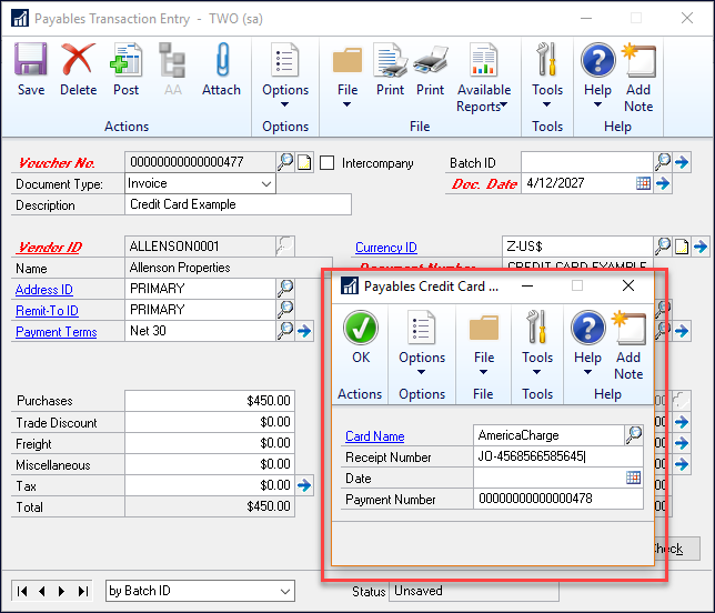

    ​HI @Eugene Mauermann
    I think I took something different from your question.  My colleagues above have provided an excellent answer if you have one credit card vendor.  It sounds like you have multiple employee credit cards.
    If you can pay them all with one check to the credit card company, then the above method is excellent.  If you require more than one credit card vendor then the above methods might prove a little more difficult.
    So, if you do have ONE vendor, but want to keep up with who's card made what purchase, then upon entry you can click the credit card payment field as in Kristen's example above and enter more information about who's card was used.  In this example I am distinguishing that it was Jo's card and her card number (or you can use receipt number or merchant name, etc)
