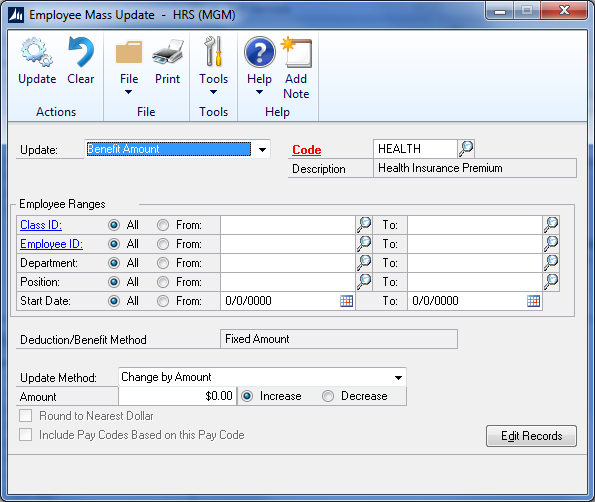

    @Krystal Smith -- it could be that you currently have a payroll in process, and these employees have a zero transaction pending (like a benefit or a deduction).
    For example, if you record benefits on the first payroll of February, and one of them is on the benefit list (with a benefit amount of zero), GP would consider this an unposted transaction.
    I would look at your benefit codes and your deduction codes and see if this is the case.  Go to HR & Payroll > Mass Update > Benefit Amount (or Deduction Amount) > HEALTH (or whatever other code you suspect)
    Inline image 1
    Choose "Edit Records" ----> and see if they are listed on the resulting Edit List
    If they are listed, and there is a payroll being processed right now, you should be able to inactivate them when the current payroll is completely processed.
