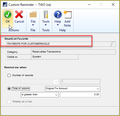

    The best way is to set up a Reminder (these are user by user, so you may have to set this reminder on more than one user if needed)

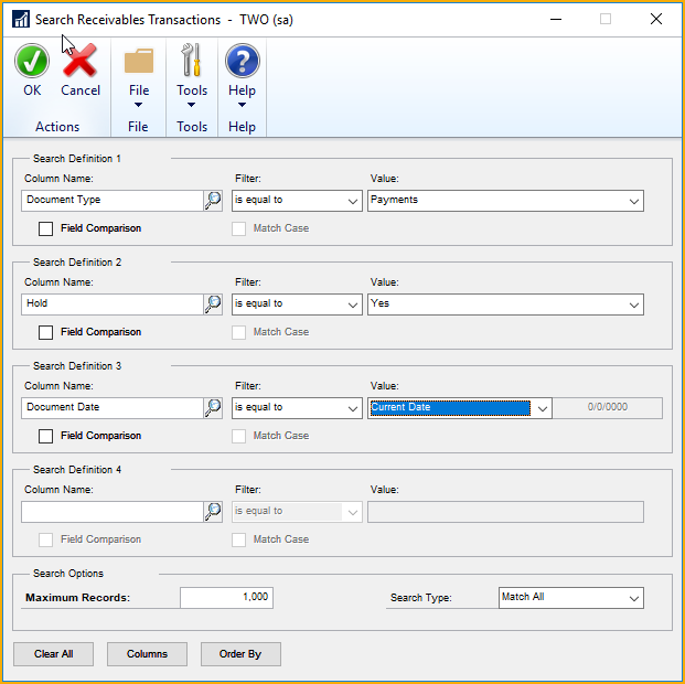

    Start by building a SmartList on Receivables Transactions:
    Go to SmartLists>Sales>Receivables Transactions
    Add the columns "Hold" and "Original Transaction Amount"... you may also want to add columns like customer balance, etc for your own information
    Click Search and set these parameters:
    Hold = Yes
    Document Type =Payments
    Original Trx Amount  "is greater than" 0
    Document Date = (change the field that says "enter date" to Current Date - If you want to set it "between" or some other range you can
    Click on "Favorites" and give it a name and add it as a system favorite with Reminder.
    On Reminders click new and choose the SmartList with the name you just named
    then click Total of Column and choose "orginal trx amount", set it to "is greater than" and the value should be 0

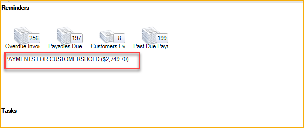

    Hit Okay and then back on your home page a value will appear if a Customer on Hold makes a payment in the date range specified.
    When the reminder pops up you just click it and it opens the SmartList and you can see the Customer(s) that made a payment while they were on hold.  You can even then double click the customer line and it will open the Customer Card.. cool stuff!
    Here are some screenshots of this alert that I set up this morning as a test:
