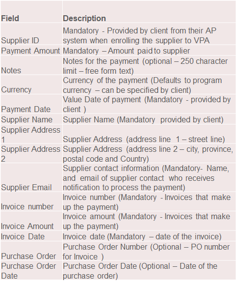

    Thank you for your reply.  TBH, I don't know exactly what we need.  Our bank provided us a list of 4 file types that they claim our ERP should be able to produce.
    EDI820 - Industry Standard
    Excel/CSV
    Flat File
    ISO20022/XML
    with these specs.
    File Specs
    so as long as GP can be set up to create any of these files types, i guess it doesnt matter which one we end up moving forward with.
