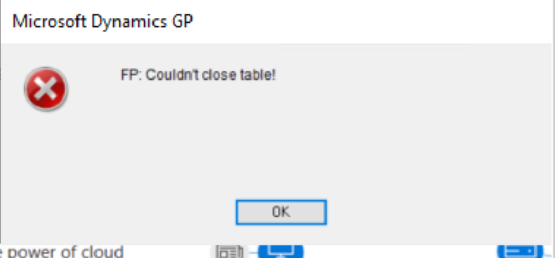

  • 1.  Do you know why this message pop up
    Posted Oct 28, 2021 02:00 PM

    Hi Simon -
    This message means the connection between the application and SQL server database was lost due to network drop, server reboot, SQL server restart, etc. If you click OK to the message(s) GP will close and then allow you to log back in normally.

    Simon,
    Take a look at this and see if this helps:
    "FP Can't Close Table" Error when accessing windows or reports in Microsoft Dynamics GP
