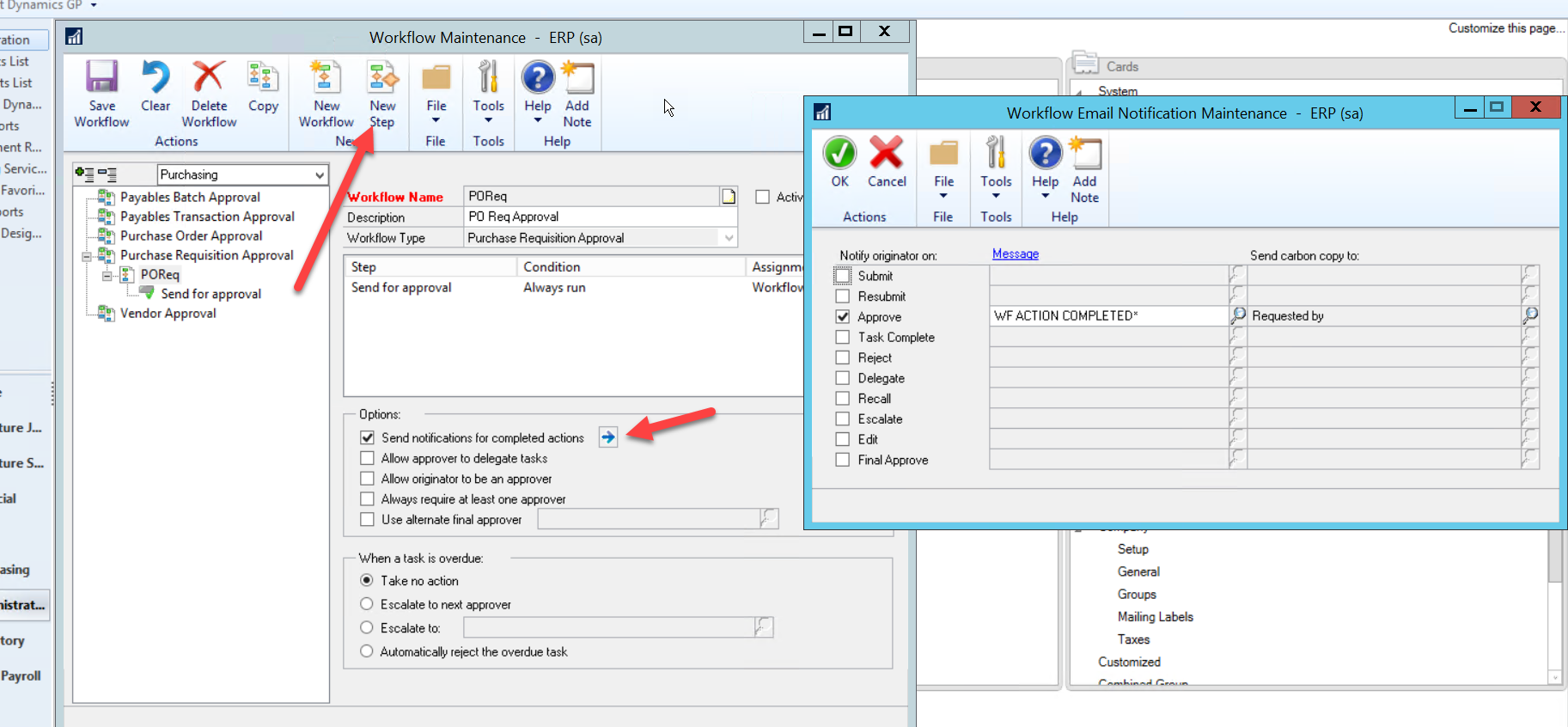

    This would be a perfect example for using the Workflow within GP.  It is found under the Administration menu under company and Workflow.  You can create a workflow that sends the requisition to an approver and, when approved or rejected, it can send it back to the requester.  Here is a little screen print to show you.
    PO Req

    We do already have this in place. The problem is that the workflow is only notifying when the purchase requisition is approved, not when a Purchase Order is generated.  Many of our purchase requisitions don't hit the workflow queues because of the dollar amount.  We could have a notification when any purchase requisition goes through the workflow, but it still wouldn't be notifying users when a PO has actually been generated.
