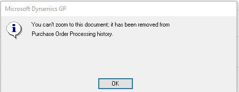

    When I run a SmartList report for the September time period for a particular purchase order, it shows up CLOSED.  When I run a payables transaction SmarList, for that purchase order, it correctly shows the three invoices.  When I clicked to drill down, the message was

  • 6.  RE: Unable to see Purchase Orders
    Posted Oct 22, 2021 11:06 AM
    Then I'm afraid that your Admin has actually removed historical transactions from your POP module.. or moved them into another company ?
  • 7.  RE: Unable to see Purchase Orders
    Posted Oct 22, 2021 11:37 AM
    Thanks for confirming what I was seeing.  An "oops" but still.  Luckily we have the alternate source to research.  That was the point of the external database, to consolidate payables transactions and simplify reconciling the vendors statements.  For all vendors they maintain ONE receivable for our invoice regardless of which company's purchase order requested.
