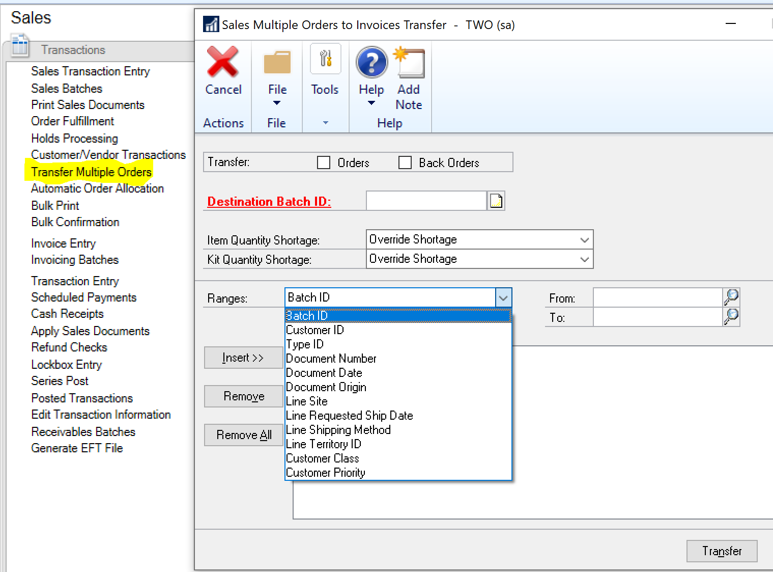

    Can you be a little more specific on the ask?  GP is crazy easy to transfer orders in bulk to invoice so not sure why you need an ISV, but there are also some great auto-posters out there for GP that are not very expensive.
    If you highlight what the issues are with needing to transfer and then auto-post we could be much more specific.​

    I agree with Jo in that GP has easy options for mass transferring orders to invoices.  If what GP does what you need in the Transfer Multiple Orders then Blue Moon products are great and there is PostMaster by Envisage.
    If that window in GP doesn't allow the restrictions that you need you need, check out https://willoware.com/gp-powerpack-mass-batch-change.  It let's you set detailed criteria on how you want to transfer.
