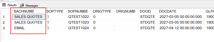

    Once you figured that out, run a query in SQL against the SOP10100 table and get all the documents that are open (SOP10100) with the DOCID matching your Sales Quote ID.
    select BACHNUMB,* from SOP10100
    where DOCID like 'STDQTE'
    The result will show you if those documents are already assigned to a batch or not.
    With this information on hand you then assign all the Sales Quotes to a single Sales Batch (existing one or a newly created one for that purpose) by using this script:
    UPDATE SOP10100
    set BACHNUMB = 'SALES QUOTES'
    WHERE DOCID = 'STDQTE'
    Once you have them all under a single Batch, you just go in GP, select the batch and delete it. That will get rid of all the related Sales Quotes.
