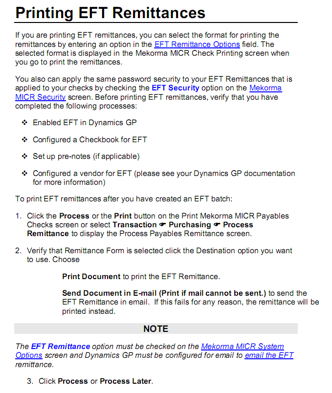

    You didn't mention the use of Mekorma in the initial post and that changes quite a few things.. Natively GP doesn't save any file for EFT remittances, unless you print them out. When using Word Templates, you can select whether GP sends those in PDF, DOCX or XPS format. Mekorma allows you to specify a location where those EFT remittance reports will be saved in the case they can't be e-mailed out.. This is what I found in the documentation of MICR below.
    I'd make sure you have the latest build of Mekorma installed (build .83 if not mistaken) as there have been a few updates with the latest GP releases by Mekorma.
    If you're still experiencing issues with the Remittance emailing, I'd contact the Mekorma support which usually is very responsive and helpful.

    Could you do some testing by using an alternate DYNAMICS.SET launch file where 3rd-party software would be excluded and see if sending EFT Remittances works ? Make also sure that all your vendors are setup properly with a valid e-mail address.
    Go thru the checklist to make sure nothing is missing: https://docs.microsoft.com/en-us/previous-versions/troubleshoot/dynamics/gp/email-pm-eft-remittances-steps
    https://support.microsoft.com/en-us/topic/quick-step-guide-to-e-mail-pm-eft-remittances-in-microsoft-dynamics-gp-2015-gp-2016-5fb82cbf-b7b9-c41c-e2e5-48ca3838dbfa
    The later KB article mentions also specific settings when Mekorma is used..
