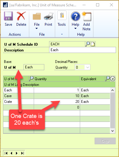

    Hi @Augusto Reyes
    The first thig I would check is make sure the U of M schedule is correct - this is an inventory setting and 'tells' GP how to translate the LB to the base unit of measure as such:
    If the issue is Wennsoft then you should contact THEIR support line - they are super helpful and quick responding.

  • 3.  RE: Purchase Orders & Wennsoft committed cost
    Posted 9 days ago
    I checked the units of measure of the items and they are correct, the issue persists.
    Thanks!
