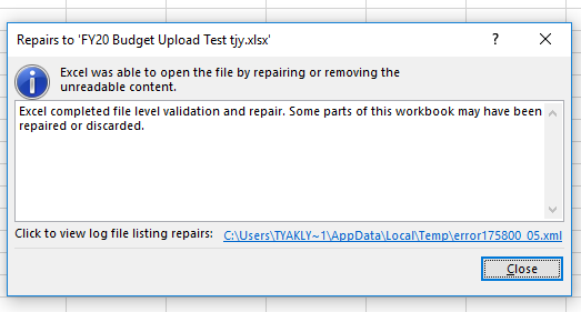

    ​​Good morning.  I am attempting to upload data from Excel into a GP budget using the budget wizard for Excel.  The first error I receive states that the number of budget periods does not equal the number of Excel columns.  Has the template for upload changed?  We have Account, Description, Beginning Balance, a column for each month and a Total column.
    When I attempt to then access the Excel worksheet, I receive the message below regarding the worksheet.
    Any ideas on what is going on?  Thanks, Tracy

    Using the Budget Wizard for Excel, can you create a Blank Budget and use that as your 'template' instead?

    I had the same issue.  After looking at the columns the creator had added a small column or two for readability.  I agree that you may want to export out a blank budget to assure you have the exact number of columns.

    Check the column headers in your excel import file.
    Sometimes GP experts out dates as your headers. There import routine can not process dates as labels.
    Change the headers to just month names or periods 1 -period 12
    And then try re-importing.

    I ran into the same thing today.  Make sure:
    1) Your headers are the same as the budget template
    2) Your headers are in "General" format (used to be it had to be in text)
    Kim Chambers

    What we will do if our customers have issues with the operations people changing the template format is to put the template on Sheet2 of a spreadsheet, copy it to Sheet1, use basic formulas to link the two sheets then hide Sheet2.
    That way if they change something they shouldn't on Sheet1 they don't mess up the template.  When you unhide Sheet2 and look it over, any major changes they make will throw out issues with your calculation so they should show up fairly easily.
