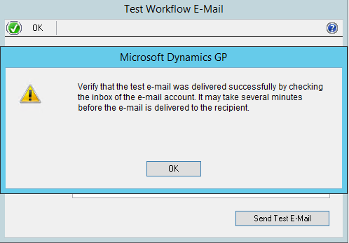

    Web Services for Microsoft Dynamics GP 2015 was configured and working at our Disaster Recovery site, until Dynamics and Company Databases where restored from our Production environment.
    The challenge now is we cannot get the email sent out from GP.
    Kindly advise if there is any script that must be executed after Database restore.
    WorkFlow Setup
    Below is the message when trying to manually test email flow; however nothing is receive in the e-mail account.
    We have tried Excahnage and Mimecast SMTP server name without any luck
    Assistance or guidance in this regard will be appreciated.
    Emails Message

    With our current ODBC connection pointing to SQL, the email relaying from GP uses that SQL server (but NOT SQL MAIL) to relay the emails out - so we had to allow/accept email relayed from our SQL server IP (NOT GP application server IP) address via our Exchange.
    This is because our Exchange accept relaying from specific IP addresses, not just any IP.
    Thanks again for all the guidance and support.
