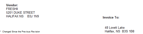

    ​Hi,
    On our standard Purchase Order that prints from GP is the field Invoice To: . Where is this pulling from. I can not find it and need to update the address

    Unless you have a modification, I think that is the Remit To address from the Vendor Maintenance card.

    It is based on a Company Address and detail vendor Entry.
    See this post for further explanation...
    https://community.dynamics.com/gp/f/32/t/114575

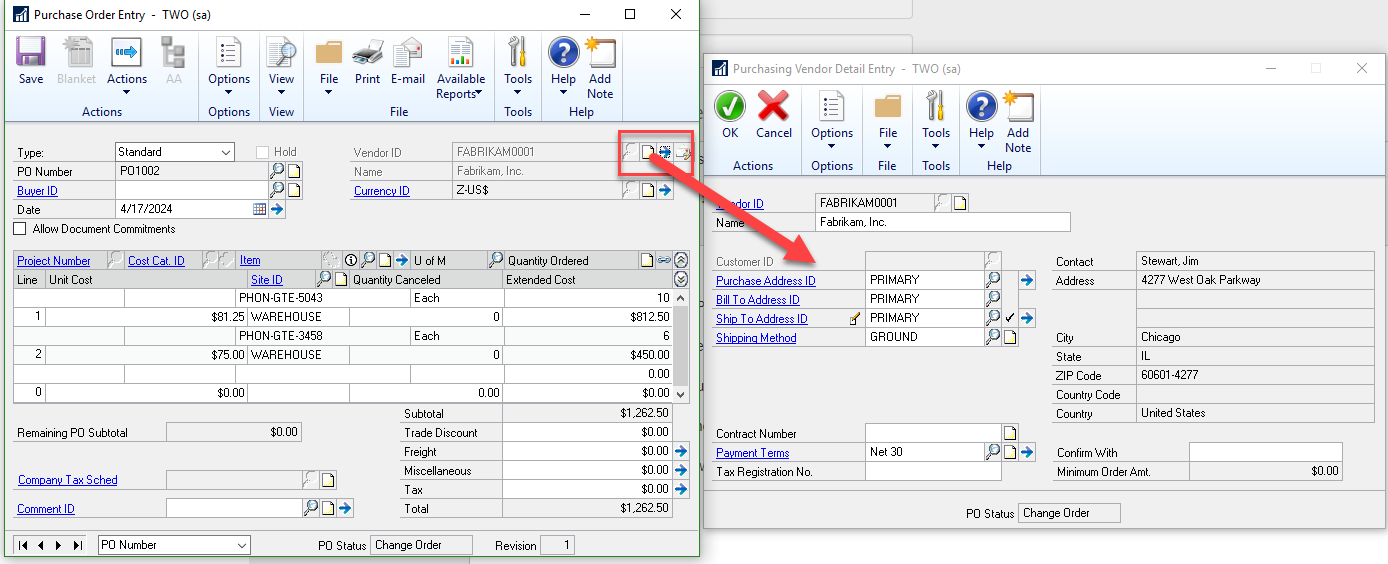

    Hi @Deana Davis
    "Invoice To" is not usually on the GP Purchase Orders so this must be a customized form that you're printing out.
    It is likely the "REMIT TO" on the Vendor Card OR it could be any number of the addresses in the transaction.
    To see those, open up the PO and use the Blue Expansion Arrow next to the Vendor ID field to see all of the addresses tied to the PO.
    If the address is not one of those, then it is on the Vendor Card somewhere.
    To be absolutely sure, you could always print to screen, hit the MODIFY button and check out the fields on the form in Report Writer.
