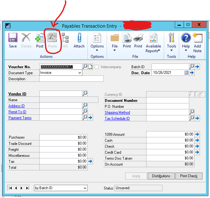

    We are trying to copy and paste Purchasing transactions from Excel into the Purchasing Transaction Entry and Distributions windows, however, the Paste button is grayed out in both windows.  We have GP 2018, version 18.3.1200.  The Security Administrator is logged in, the Multicurrency module is enabled and Action Pane is selected under Window Command Display in User Preferences.  It's possible we have had third party modifications to the menu.  Does anyone have any suggestions?  Thank you!

    Hi Dora,
    There are some tricks to this feature!
    I would make sure you have the vendor pulled up in your window.
    Here is a blog they we wrote for the feature that talks about steps to take, especially with distributions window too
    (+) Microsoft Dynamics GP Fall 2020 - Copy and Paste Purchasing Transactions and Distributions - Microsoft Dynamics GP Community
    I would review the TIPS section, we did have one issue if you did not register multi currency it was not available either, that was fixed in March of 2021
    Tips:
    This feature will also work in Web Client.
    Just like General Ledger copy and paste, if you mark the Intercompany checkbox the Paste option is unavailable.
    If you do not have multi currency (MC) enabled (Tools | Setup | System | Registration) the Paste option is unavailable.  Fixed in Mid-Year 2021

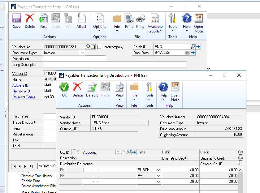

    We just upgraded to 18.4.1436. Multicurrency is on, Intercompany is NOT checked, but the box is still greyed out. Action Pane is selected for the user preferences.
    I've tried searching and found a post about the task for the exception report needs to be assigned, which I've done. There doesn't seem to be any other tasks about this feature and it's not working for sa, so I'm at a loss.
    Any other suggestions?

    I would test first with just the core window as the distribution window is tricky, does the paste work with the core window?
    You are showing both above so want to make sure.
    To test this, just clear your screen, what I would like to do is have the voucher filled in, then go to the vendor ID field, once I choose a vendor and it pulls in, mine is available right away.
    I have some of these tips noted on the release blog of the feature
    Tips:
    If you do not have multi currency (MC) enabled (Tools | Setup | System | Registration) the Paste option is unavailable (fixed in mid-year)

    Thank you!
    It looks like it's working now!
