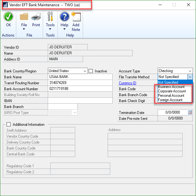

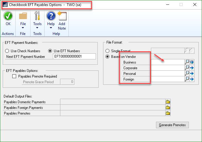

    Each Vendor REMITTO Address has the EFT setup window and in here you designate the Address as CCD, PPD etc under File Transfer Method. That selection then determines the EFT file format based on the assignments done on the CheckBook Card EFT Bank Payables Options.

    Set up the two types of EFT Format in Financial>Cards>EFT File Format with Unique names.
    If you use one with one bank account and the other with another bank account then it will be whichever Bank Account you use in conjunction with the Vendor's EFT Address on the transaction that determines the file format used.
    If you must use different formats with the same bank account (check book) then in the Check Book EFT Window select the correct format for the "Vendor EFT Type", and then on the Vendor Card, use the "File Transfer Method" field to select the "Vendor EFT Type" there.
    Bear in mind it will be one EFT File Transfer method per Vendor Address, so if you need more than one on each vendor you would set up different addresses for each one and just be careful when selecting addresses during transaction entry.
