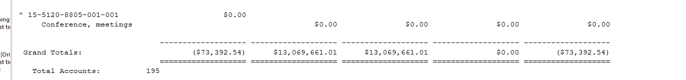

    Does anyone know by chance where the beginning and ending balance is stored at for the Trial Balance reports are? I reconciled my GL and still have these numbers I don't know how to get rid of!!
    Thanks for any help!!
