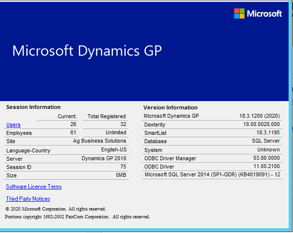

    Hello,
    Our version of GP currently is MS 18.3.1200 (2020).
    We would want to current year tax update done. Can the latest upgrade be installed on this version without having to go through a huge upgrade?
    Thank you for your time,
