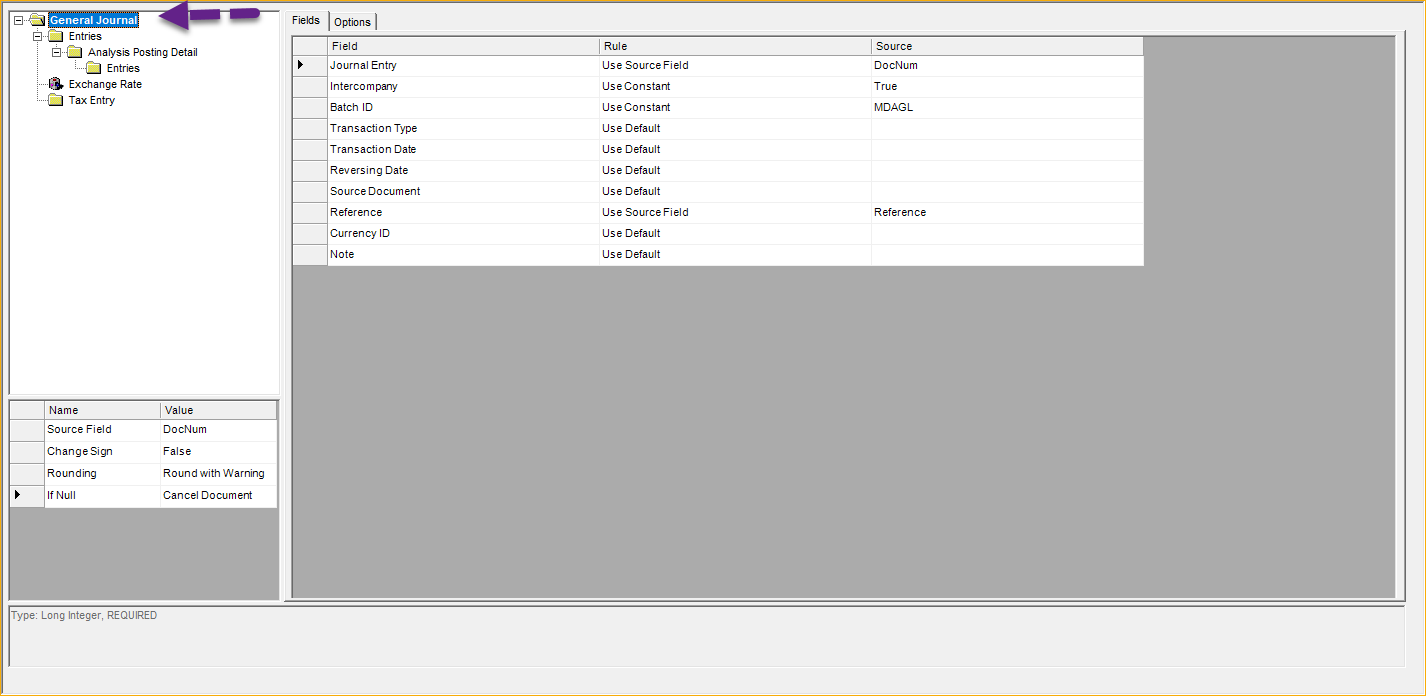

    But, basically, in IM like SmartConnect it will be how you are grouping the transactions, so you need to populate the regular JE fields at the header and entries level:
    And then you need to fill in the 'Analysis Posting Detail' (sort of the header for MDA)
    Then the Entries (Detail for MDA)

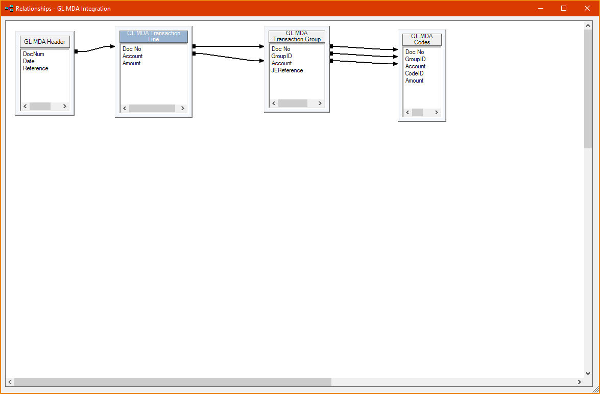

    My Groupings on the source data look like this:
