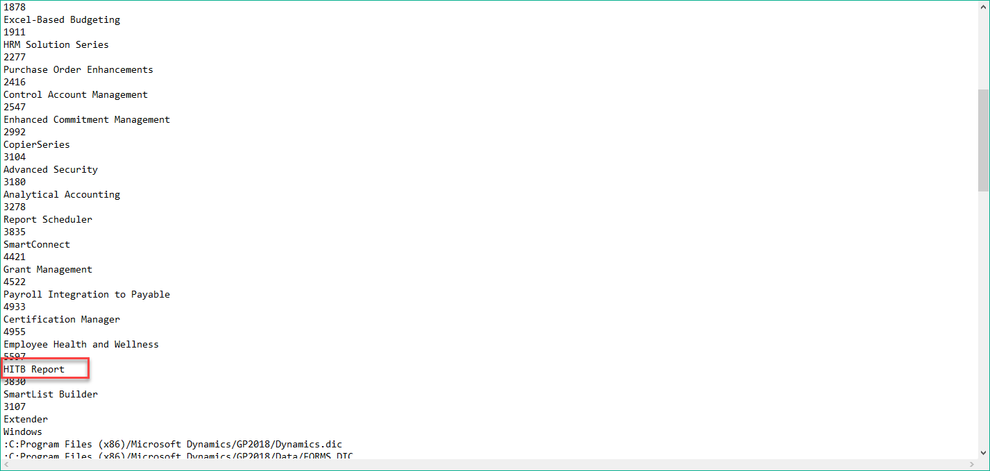

    We can better help you with just a bit more information.  I need to know if the HITB was installed for you guys during the upgrade.
    Right click on your GP Icon and click Properties and "Open File Location".
    Double click to open the Dynamics.SET file - if your system asks you, choose to open it as a Notepad file.
    In that file you should see that the HITB report has been installed.  See screenshot below.
    If it has been installed and you cannot see it, let us know.  If it was NOT installed, get in touch with your partner to install that product again (THEY SHOULD NOT CHARGE YOU TO FIX THIS).

    I went through the steps as you suggested.  The HITB was installed with the update, but I don't see it as a report in the GP program.
