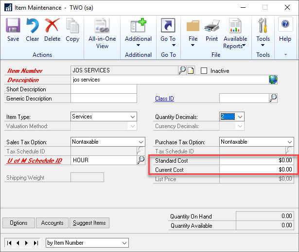

    ​When you say it's a Non-Inventory Item are you just meaning that it is setup IN inventory, but as a "Services" Type of item?  Or do you mean you are not keeping it in inventory at all and just typing it in?
    If it is set up an an Item, but with a "Services" type, have you in-put a cost in the current or standard cost window?
