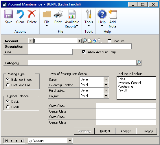

    Is there a way to make User Defined fields in the account maintenance window required?
    For me it would be State Class and Center Class.

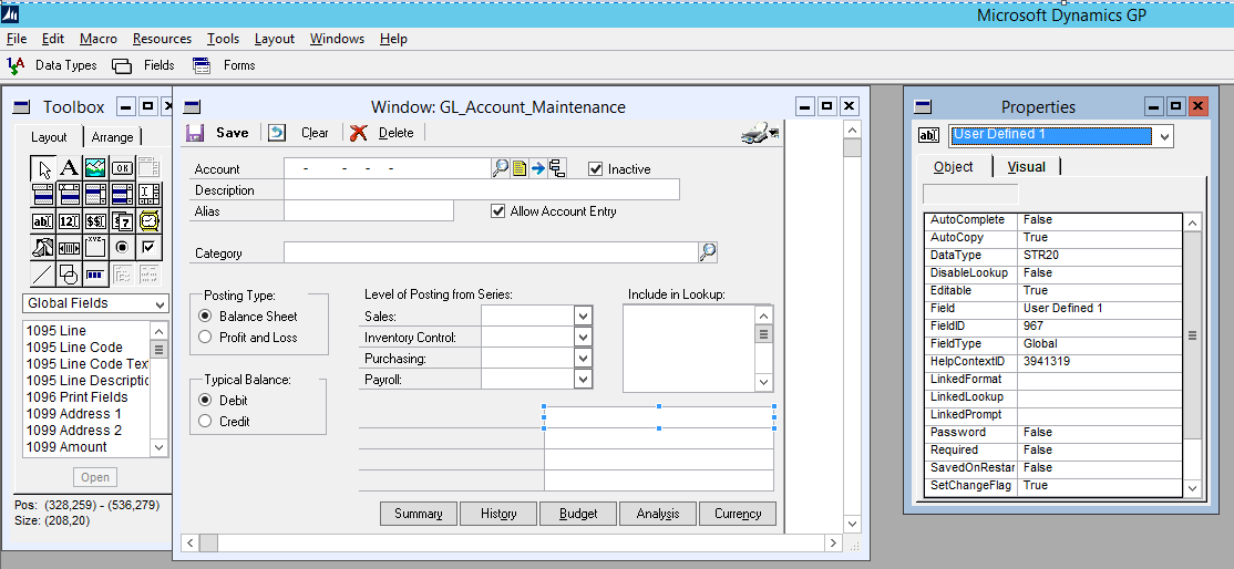

    The one way that I would do it is to modify the window.
    If you are using a shared Modified Forms Dictionary you will need to do this when everyone is out of the system.
    With the window open you can go to Tools > Customize > Current Window.
    Find the area where you enter information for User Defined 1 ​and mark Required to True.
    You can do this with the other user defined fields as well.
    You will then need to change security to use the modified form.
    Acct Maint Modified
