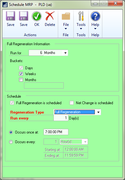

    Has anyone seen this before?
    GP 2018.
    Screen

    You see two Save buttons because there are two sections in this screen. One Save button is for the changes made to the "Full Regeneration Information" section and the other is for changes made to the "Schedule" section.
    Using the "Action Pane" displays for the GP window commands can make this some confusing in Schedule MRP window. If you go to the User Preferences and change your Display to "Menu Bar", you will see that the two save buttons move to their appropriate sections. You can also see what I mentioned if you modify this screen.

    Thanks for the response.
    I changed my display to Menu Bar then had to log out and back in.  I see the display changed now.
    Pref
    Change
