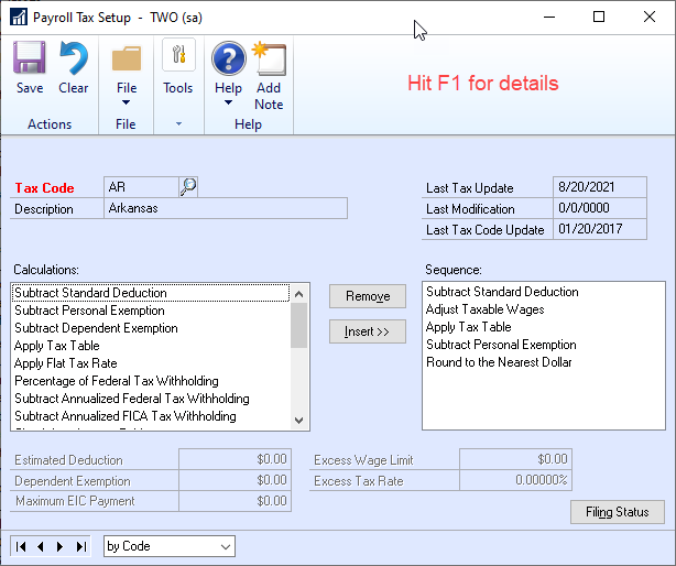

    If you go to the Payroll Tax Setup window, (Administration >> Setup >> System >> Payroll Tax) and select a state, like Arkansas:

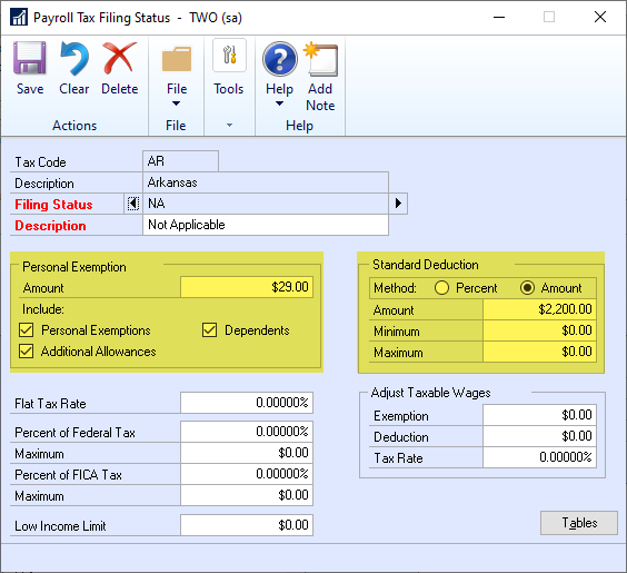

    The sequence in the right box will tell you how the tax calculation will operate for that state. You can also hit the "Filing Status" button to see more details:

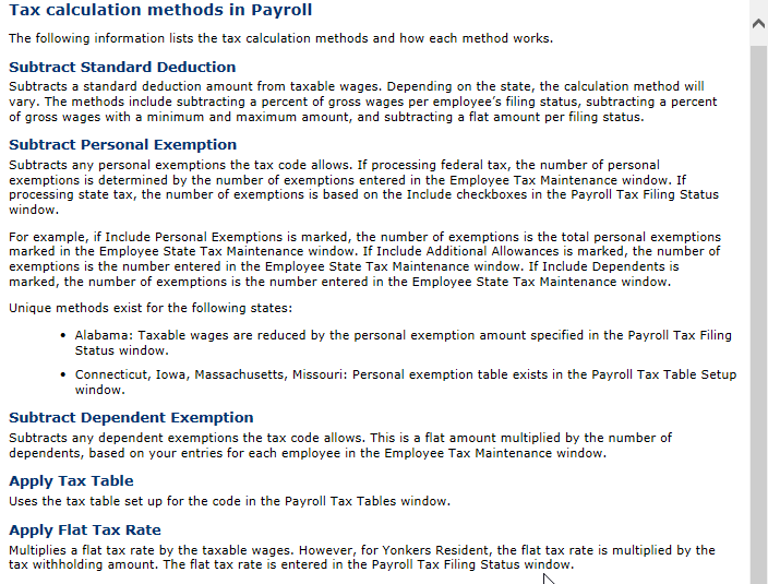

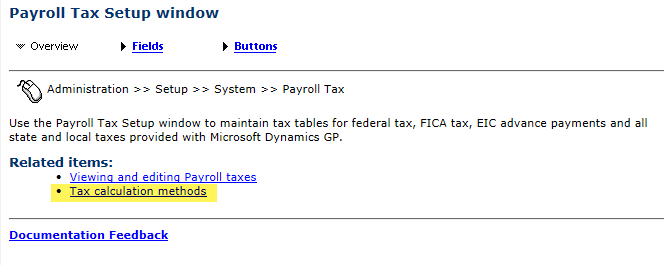

    Also, by hitting the F1 key on the main window, the help will allow you to see the details on the calculation methods:
