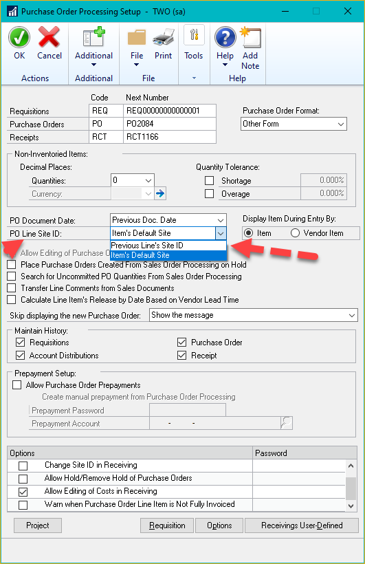

    Hi @Melissa Hyman
    How are you guys initiating the drop-ship?  It sounds like you are initiating from a PO as opposed to a Sales Order (the differences in how they are created are great, and you may have your reasons for not initiating it from the sales order or return, but creating the drop ships from the Sales Orders are usually the best method).
    IF you must kick it off from the Purchase Order, there are some settings that will allow you to auto-populate the last line-entered's ship to address.
    In Purchasing>Setup>Purchase Order Processing, choose to use the site ID from the previous line and NOT the Items default Site ID.
    You have picked up on one of the frustrating aspects of PO's that the Ship-To on the print-out of the PO will not be populated by the address at the Header-level of the PO (Where you choose vendors, etc) but is populated by the individual lines.
    This is both good and bad, it's good because you can actually use ONE PO to ship to multiple locations as a different page of the PO will print for each line with a different Ship To, BUT, you can't really roll-down changes to the ship to from the header-level.  Not the way you'd want to anyway.
