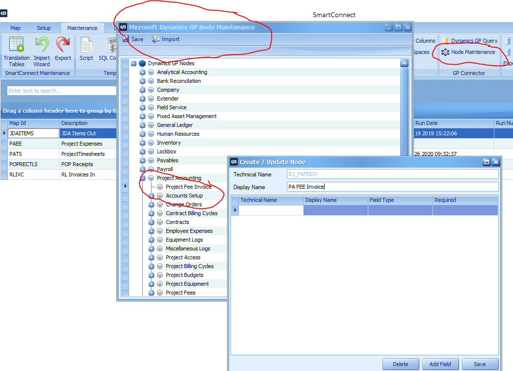

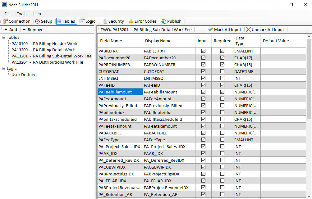

    1.Use eOne Solutions addon to Smart Connect  called Node Builder to build a new PA Fee Invoice Node. See screen shot showing the four primary PA tables making up the new Node we called PAFEEIV. Yikes this is old! V 2011! Sorry about that!
    2. Once that Node is created it is ether published to SmartConnect as a new node or the XML created can be imported into Smart Connect under Node Maintenance. In either case Node Builder will be creating a new SmartConnect stored procedure and a new pre and new post stored procedure for the new integration that you can then Map as normal using SmartConnect features.
    3. However in PA, there are also several columns in the PA Periodic and PA Master tables for Customers, Contracts, Projects and Fees that also get updated for unposted billing transactions. We found the best way to update these fields short of running the full Utility for PA Reconcile Billing Transactions and PA Reconcile Periodics on each integration was to run the new PAFEEIV post stored procedure with a modified paRecxxxxxx stored procedure to reconcile the PA Master and Periodic tables based only on Customer, Contract and Project/Fee integrated. See new pre and post sprocs below along with new encrypted integration sproc for PAFEEIV
