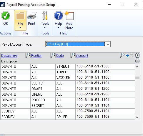

    Does the use of additional positions on the employee maintenance card have any effect on the posting of gross payroll expense or is it for HR informational purposes only? We have part time employees that work in different positions in different departments and have set up those positions on the additional positions screen. We were hoping that it would carry through with the posting of payroll expense to correct general ledger accounts based on these additional positions. We also made sure those positions were set up in the payroll posting accounts setup. This did not work and it appears to only be looking at the position listed on the employee maintenance card. The only way we have been able to get the posting to the correct general ledger account is to set up the same position in a department where it doesn't really belong on the payroll posting accounts setup.
    For example, the position on the employee maintenance card is Life Guard in the recreation department, and the additional position is working special events for downtown promotions department. We can get it to post correctly if we also set up Life Guard in the downtown promotions, which looks strange.
    We are on GP 2016. Is this possible to do in advanced payroll, which we don't own? I know Integrity Data offers a solution that might handle this situation. #HRandPayroll

    The Position on the Employee Maintenance card is simply the default position that is populated in Payroll Transaction Entry.  The Position can be changed for each entry in the payroll transaction to change the reporting as you suggest.  The Payroll Posting Account Setup will need the correct combination of Department, Position, and Pay Code to control posting to the proper GL accounts.  "ALL" can be used in any column when appropriate but does not have to be used, as long as all combinations of Department, Position, and Pay Code are included.
    I think your real challenge will be in determining how this setup will affect your payroll reporting as a whole.  The GL posting is only one piece.  You will need to look at all aspects of reporting (i.e. HR, Operations, Tax, Legal, etc.).  We use this type of setup extensively with the standard payroll module.  However instead of using Transaction Entry we import our payroll transactions from another source.  We also have not implemented the HR module and we created some custom reports to accommodate our reporting needs.
