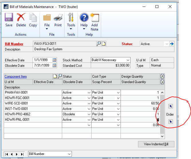

    You could force the sort on the Report in RW Sort Options to be by component item number but I think you may want to show your staff where they can change the sort on the BOM themselves.
    This is done on the BOM itself using the up and down arrows on the right hand side. See below.
    You can also use "right click insert row or delete row" to insert and delete rows where you want them.
    Then when the BOM prints, the components will be in the exact order the BOM is set up for. This is better than you forcing a sort on the Report. Let the BOM users set and maintain the sort.

    If you set the sort on the BOM Card, then all the later reports will also follow that sort including Sub Assembly components.
    So Reports - Inventory - Analysis - Assembly Analysis for example would print sorted the way the BOM was setup.
    However, if you change the sort on the BOM Assembly cards, the change is NOT retroactive to Posted Assemblies. Only to new Assemblies posted after you make the sort change.
    If you start changing the SORT in the Report Writer Sort Options then it will not matter what the users do in the BOM Assembly cards sort arrows
    I hope this is SORTA clear. Pun intended!
