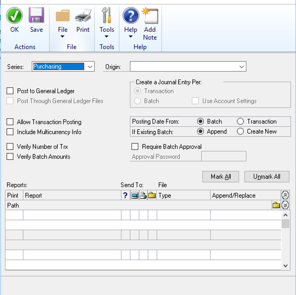

  • 6.  RE: Computer Check Posting Settings Changed
    Posted Apr 10, 2019 03:48 PM
    ​HI Deana,
    This could be a training issue.  If the user opens the posting setup window and selects a series, then all default settings are displayed for purchasing.  If you click OK, all of purchasing will inherit the default settings as shown below.  Users should click the 'X' if they do not want to save changes.
    Posting
    Louie Hoerner
    AIM Technologies
    Madisonville LA
