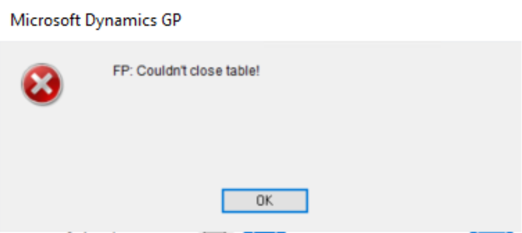

  • 1.  have any one getting this error
    Posted Oct 28, 2021 03:38 PM
    We get this error when the receiving job is running.

    I see this when Trend Micro is installed and the temp files have not been excluded from scanning.   Here is a good article describing it.
    https://winthropdc.wordpress.com/2010/04/20/unexplained-temp-table-errors/

    Either AV or network connection issues..
    See if that helps: https://support.microsoft.com/en-us/topic/-fp-can-t-close-table-error-when-accessing-windows-or-reports-in-microsoft-dynamics-gp-a57a28ab-c9c3-0cc7-0b87-0c4c3f4de512
