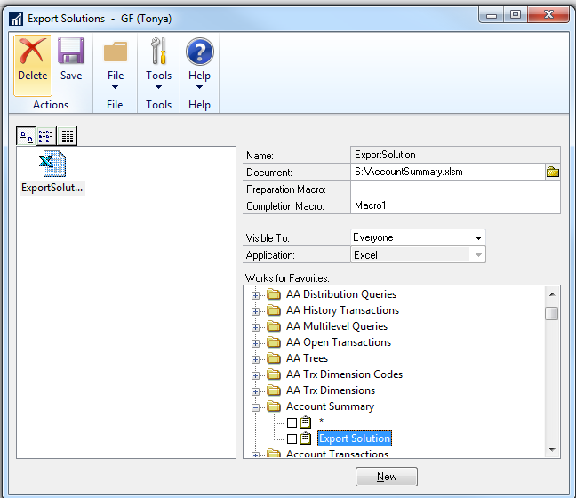

    I have created my first Macro enabled saved excel file and followed the instructions to save it to use through the export solutions in the smartlist. However I am not seeing the drop down arrow to choose between export solution and quick export even after refreshing the smartlist.  I am currently using GP2016
    the steps I took...
    1. ran a smartlist
    2. exported to excel
    3. ran macro
    4. deleted all content and saved as macro enabled spreadsheet.
    5. saved a new favorite in smartlist and chose the macro enabled spreadsheet as the export solution
    Export solutionhowever once I close it, refresh the smartlist and click on it to use it I do not get the drop down arrows for the choice between the quick export or export solution.  Did I miss something...does something need to be turned on for this feature to work?

    Hi @Tonya Ladner,
    From your screen shot it looks like the Checkbox next to your favorite is not checked.  Also, I don't remember if you have to close SmartList & reopen it for the option to be there.​

    YES!! That fixed it!! Thank you Thank you!!
