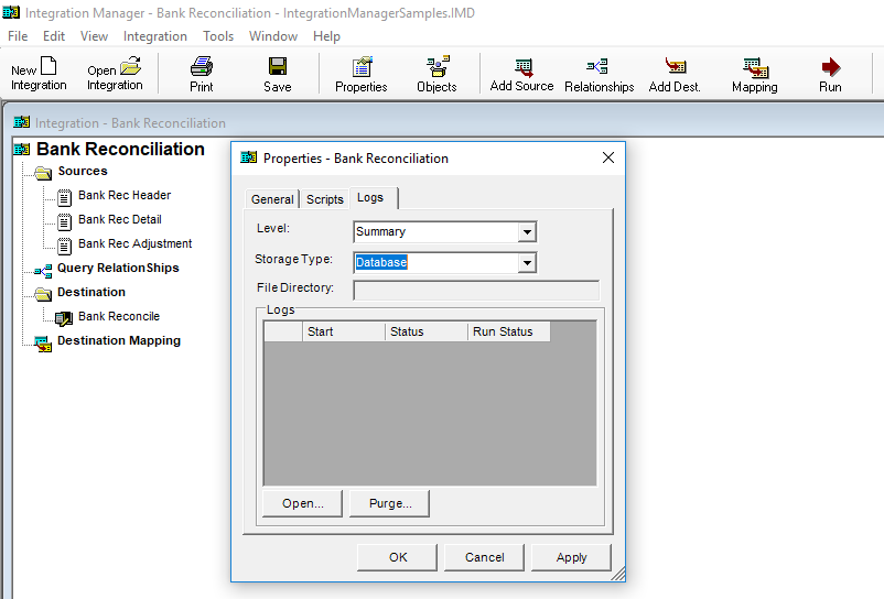

    Hi Phuong,
    Can you please check if your integration* is using a "Database" Storage Type?
    * Right click on the Integration file (e.g. Bank Reconciliation) >>  (Bank Reconciliation) Properties  >> Logs tab >> [change to File, edit path] >> Apply
    If yes, see if setting this to "File" (and assigning a corresponding path that both users have access to) stops the error from coming up?
